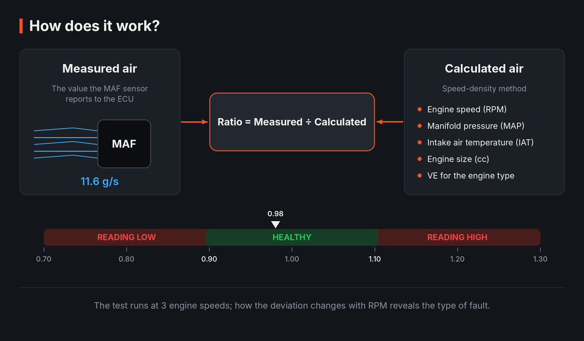

    What does MAF Checker do?
    The MAF sensor measures the air entering the engine, and the ECU largely calculates the fuel quantity from that value. A dirty or ageing MAF under-reads; the engine hesitates, loses pulling power, and fuel consumption and smoke increase. The catch is that a “wrong” MAF is hard to spot in live data: you only see a number, and you don’t know what that number should be.
    MAF Checker does this comparison for you. It calculates the air the engine should be taking in, independently of the MAF, using the speed-density method, and compares it with the sensor’s reading:
    • Measured air: the value the MAF sensor reports to the ECU (g/s).
    • Calculated air: derived from engine speed, intake manifold pressure (MAP), intake air temperature (IAT), engine displacement and the volumetric efficiency (VE) of the engine type.
    • Ratio = Measured ÷ Calculated. 0.90 – 1.10 is considered healthy.
    The test runs at three engine speeds. How the deviation changes with RPM matters more than a single reading: a dirty MAF, a vacuum leak, a boost leak or a wrongly chosen engine type each leave a different signature. On petrol cars the app also cross-checks the result against fuel trim.

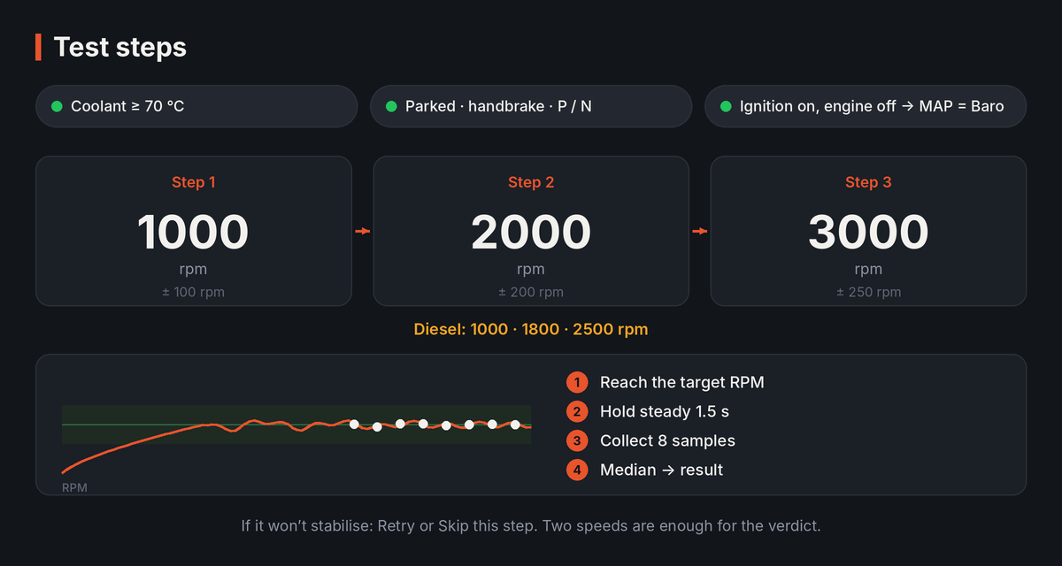

    Running the test
    1. Bring the engine to operating temperature. Switch off consumers such as the A/C, headlights and heater.
    2. Switch the ignition on and connect without starting the engine. The app then compares the MAP sensor with barometric pressure; with the engine off they should be equal. If they differ by more than 3 kPa, it warns that the MAP sensor is suspect, since the test relies on MAP data.
    3. Start the engine. The live data card shows RPM, MAP, IAT, MAF, EGR and coolant temperature. If the car does not publish MAF data, the app tells you right away.
    4. Check the engine size and press “Measure: 1000 RPM (step 1 of 3)”. If the coolant is below 70 °C the app warns you; you can wait or measure anyway.
    5. Use the accelerator to bring the RPM to the target and hold it steady. Once the RPM has stayed near the target for 1.5 seconds, the app collects 8 samples and uses their median. A single outlier does not spoil the measurement; if the RPM leaves the band twice in a row, collection starts over.
    6. When a step is done, the next target is shown: 2000 and 3000 rpm. For diesels the targets are 1800 and 2500 rpm, because many diesels limit RPM to about 2500 in P/N.
    7. If the RPM cannot be stabilised, you get Retry and Skip this step. Measurements at two engine speeds are enough for the overall verdict.
    8. After the three steps, each speed’s result and the overall verdict are shown. Press “Start new test” to measure again.
    Accepted RPM band: ±100 around 1000, ±200 around 2000, ±250 around 3000 rpm.

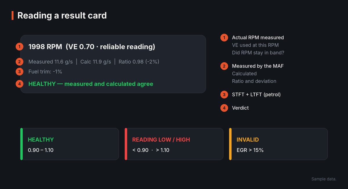

    Each engine speed produces a result card:
    • Header: the actual RPM of the measurement, the VE used at that RPM and the measurement quality. Reliable reading: the RPM stayed within the band while sampling. Unstable reading: the RPM fluctuated; the result is still used, but repeating it is a good idea.
    • Measured / Calculated / Ratio: the air measured by the MAF, the air calculated by speed-density, and their ratio. The percentage in brackets is the deviation.
    • Fuel trim (petrol cars): the sum of short- and long-term trim. On engines with two banks, the two banks are averaged.
    • HEALTHY: Ratio between 0.90 and 1.10; measured and calculated agree.
    • READING LOW: Ratio below 0.90. The MAF may be dirty or weak, or air may be leaking in after the MAF.
    • READING HIGH: Ratio above 1.10. The MAF may be over-reading, or the MAP/IAT data is suspect.
    • INVALID: EGR is more than 15% open. Exhaust gas displaces fresh air, so this measurement is not evaluated.
    A single red line is not a fault on its own. Judge it together with the pattern across engine speeds and the fuel trim.

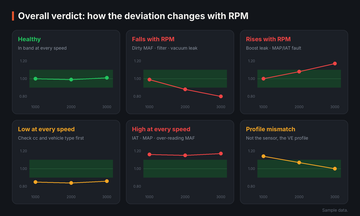

    Overall verdict: patterns
    The app evaluates all engine speeds together and picks a pattern based on the size and direction of the deviation:
    • Healthy: The deviation is within limits at every engine speed.
    • Increasingly low with RPM: Measured falls further behind calculated as RPM rises. Dirty/weak MAF, a clogged air filter or a vacuum leak between the MAF and the engine. Check the filter and intake hoses first, then consider cleaning the MAF.
    • Increasingly high with RPM: Measured exceeds calculated more and more as RPM rises. A boost-side leak on a turbo engine, a MAP/IAT fault or a MAF that over-reads at high flow.
    • Similarly low at every speed: Check the engine size and vehicle type first. If they are correct, the MAF may be under-reading by a constant factor across the range.
    • High at every speed: IAT read incorrectly (mirroring coolant), a faulty MAP sensor, a boost leak or a MAF that over-reads.
    • Profile mismatch: The deviation is larger at low RPM or changes direction across the range. This is usually not a sensor fault but the chosen VE profile not quite fitting the engine. Review the vehicle type or do a reference calibration.
    • Inconsistent / mixed: The results do not form a clear pattern. Warm the engine fully and measure again, holding each speed steady.

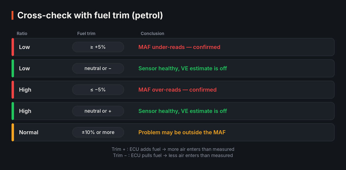

    Cross-check with fuel trim (petrol)
    On petrol engines the ECU constantly corrects the mixture using the oxygen sensor. If the MAF really under-reads, the engine gets extra air, the mixture goes lean and the ECU adds fuel (positive trim). If the MAF over-reads, the ECU pulls fuel (negative trim). So fuel trim tells you whether the ratio comes from the sensor or from the VE estimate:
    • Low ratio + trim +5% or more: Confirms the MAF is under-reading (dirty MAF or a leak after the MAF).
    • Low ratio + neutral or negative trim: The ECU is not adding fuel; the sensor is most likely healthy and the deviation comes from the VE estimate.
    • High ratio + trim −5% or less: Confirms the MAF is over-reading.
    • High ratio + neutral or positive trim: The ECU is not pulling fuel; the deviation most likely comes from the VE estimate.
    • Normal ratio + trim ±10% or more: The MAF looks healthy; the problem may lie elsewhere: fuel pressure, injectors, oxygen sensor or an exhaust leak.
    This check is not done on diesel engines. On LPG-converted cars, run the test on petrol; the LPG tune affects fuel trim.
